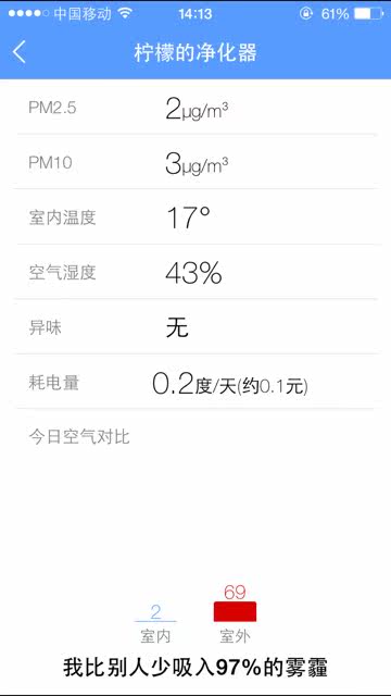

This is the Plantower device with Plantower module inside. Check out the video. The claim is quite ambitious, the device reading is very close to the China national monitoring station.
http://item.taobao.com/item.htm?spm...351&pvid=08e00fb4-2b92-418e-aed5-517ae49246cb
Actually there is a lot of theory behind particle counters. And some assumption behind the G1. I actually chatted with one seller because I got hella confused with the few bits of information there is on G1 (even the manufacturers don't provide a proper datasheet online, or at all).
The G1 actually outputs 2 concentration readings for each PM category. The story goes that when Plantower first developed the G1, they were using US TSI standardized particles for calibration (terms like CF=1, 美国TSI标准颗粒). End up the feedback wasn't too good as the PM reading is way off from China's official stations PM readings. So Plantower did additional post processing of the calibration and reported another set of PM concentration as atmospheric (大气环境) PM estimation.

Chiu all also can consider the Paomi Air Purifier 豹米空气净化器
270 m3/hr specs (tested by certification institute 283 m3/hr), 3M H12 or H13 HEPA. WiFi capable.
Built-in true laser particle counter (they claim German laser module) to monitor the air quality and display the ug/m3 concentration in front. Stylish looks. And definitely quieter than the Xiaomi, though it can be argued that the Xiaomi in medium = the Paomi high, and shd be compared as such.
Usin Japanese DC brushless motor. Shd be quite low in power consumption. (Found the power, 42W)
