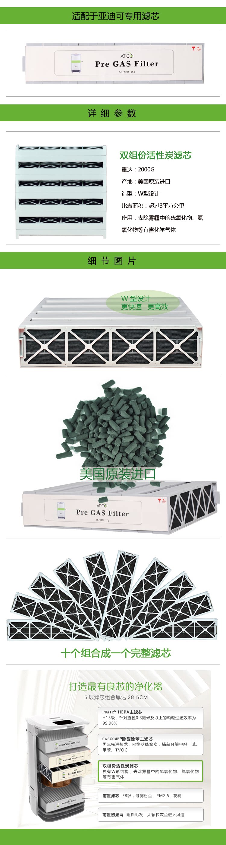

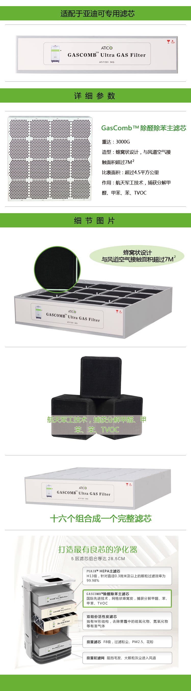

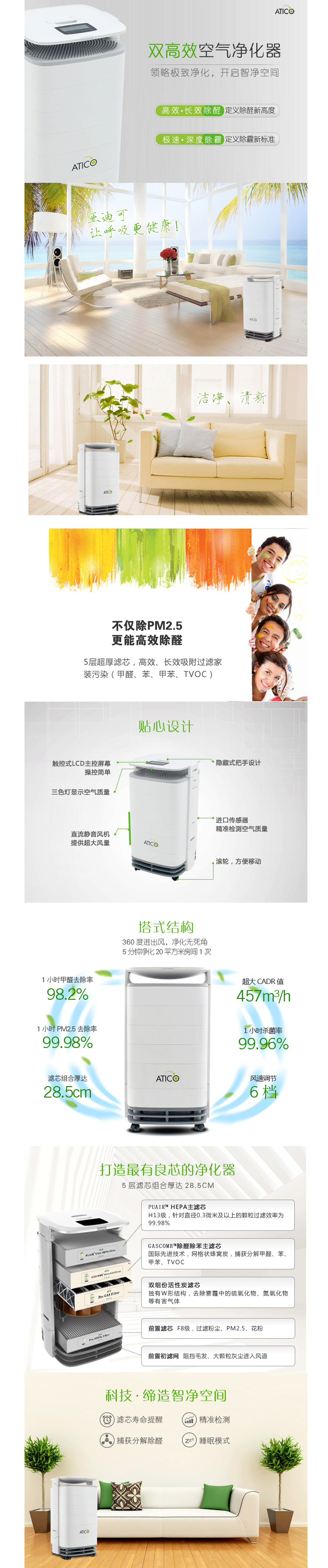

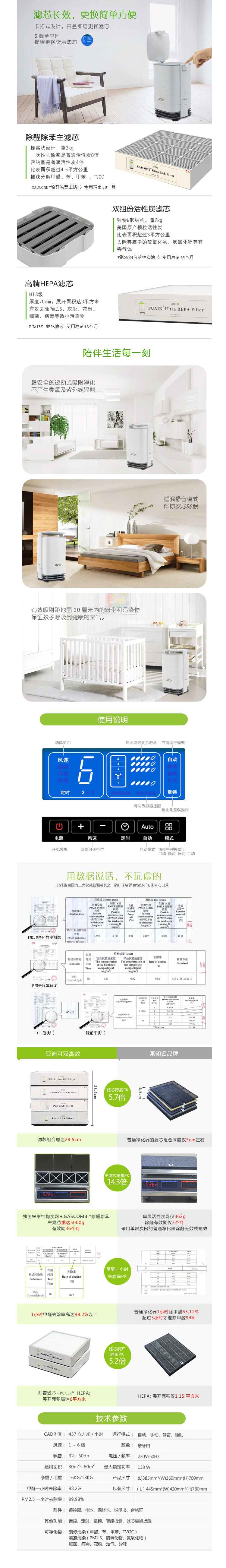

Some of the tiong stuff are pretty good. Too bad even over there in China where they need it most, such higher-end/better designed pdts are till considered niche and hence command a higher price.
200 micron net type pre pre-filter, 70mm thick F8 prefilter, 70mm thick H13 main filter. Don't know what Honeycomb gas filter and then 2kg activated charcoal filter.
Can get a unit to play if it were 2500-3000 RMB or something. The H13 filter is surprisingly cheap, only RMB300 for that big-ass thick one.
http://item.taobao.com/item.htm?spm...830&pvid=c3874df9-7269-4e37-9c5f-40e3655a8e01
Gas comb filter = 3kg
Activated charcoal filter = 2kg
