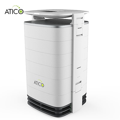

In my opinion, filtered air comes from bottom will blow up the dust on the floor.
If you look at any other air purifier design(even High-end IQair, Austin Air etc), 99% will be top exhaust clean air with bottom or side dirty air intake.
Maybe the Camfil designer's idea is that their air purifier should also function as whole room vacuum cleaner. Push all the dust back into to the air to be sucked in again by the air purifier and also anyone's lungs who is near-by. :D

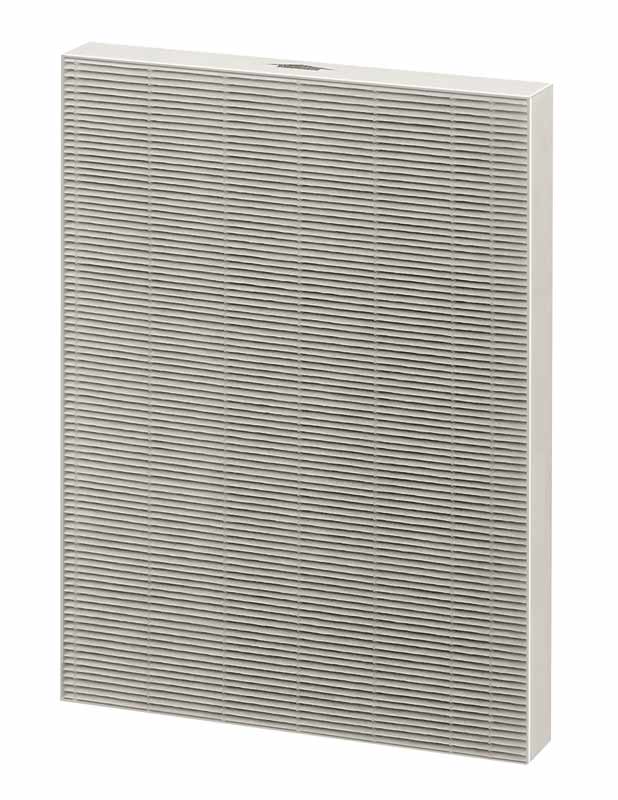

Anyone know where to buy A28 filter?
Dimensions is 280mm by 330mm by 23mm.
http://www.amazon.com/Fellowes-HF-2...&qid=1413201703&sr=8-5&keywords=fellowes+HEPA
Ok, Sharp A28 filter dimensions are 285mm x 310mm x 25mm. 1 inch thick filter
So the above Amazon H13 filter can fit. Slice up the 330mm to become 310mm (very easy coz the pleating is in the same direction) with a penknife. Scotch tape....the seal will be good.
285mm, need to use a strip of PU or LDPE foam and UHU glue to stick and cover the 5mm gap.
Or if you're not a handy person (like me, I can only destroy things :o), you can pay around ~$7/- extra to purchase the original filter for $44.94 (After GST) by going to:

BTW, cutting of filter......takes a bit of technique. Best is to use a very sharp penknife.....or those fancy hobby knife/foldable knives also can. I use my CRKT Desert cruiser, at least put it to good use. lol Just slice a bit on both sides to get the lining correct, a few times does the job. The saw through the spine.
But if cutting along the pleats, that one 12 year old also know how to do within 5 minutes lah.

so this thing is trying to make sure all the settled dust gets sucked into their filters. hmmm
Can call local agent on pricing i guess i was thinking abt how its air outlet being downward thrust might blow up dust....guess not
