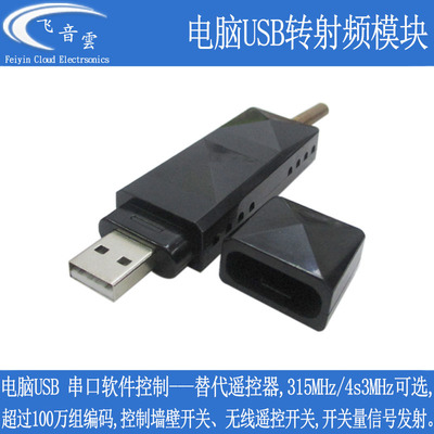

[SIC] 65k channel RF Remote
Just to share a RF remote which I recently found that is able to control my 20+ Yoogee switches. That will easily require 40+ sets of different EV1527 RF codes. This is a USB RF remote that easily can generate 65,536 different codes. With this, I am able to get my RM Pro+ to learn the codes to allow Google Assistant or Alexa to voice control all my switches.
I could have gotten one of those remotes sold in Carousell or Qoo10... but this is cheap.... Cost me slightly less than S$8 with shipping from Taobao.
With the extra codes, I can also set up special codes to simultaneously control a few switches (either ON/OFF at one go).
This should also work for other 3rd party RF Wall switches such as Funry and Sankou
so you are controlling via PC? Or?
How does this works?
