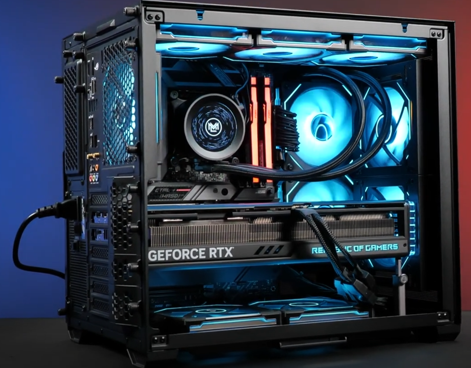

Anyone know if 240mm AIO is enough to cool the 13900k without any OC. I know some say go for 360mm but I planning to build in a o11 Air mini
poooooo
May 17, 2012
12,905
3,390
Get arctic 280? Almost near 360 performance.
If all you do is gaming might be just fine using 240.
Zakhri32
Apr 26, 2009
1,047
78
280mm possible but have to mount it on the front another consideration is if got space to put new gen cards in :confused:
poooooo
May 17, 2012
12,905
3,390
I think will be not possible haha, the rad for arctic 280 is thicker than other brand rad, if you are getting big cards have to check/ measure carefully.

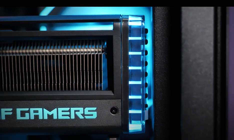

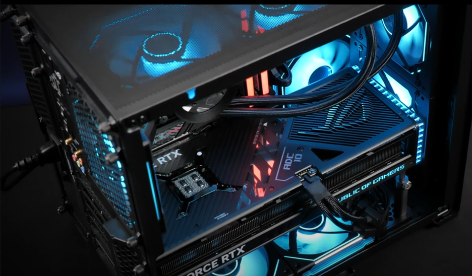

You might need to take note if ur getting the 40 series card in the future
Zakhri32
Apr 26, 2009
1,047
78
Yeah I saw this video, was planning to get this Asus version as well but probably will hoot the FE instead, can get the ROG version if I decide to go for a O11D Evo instead :ROFLMAO:
