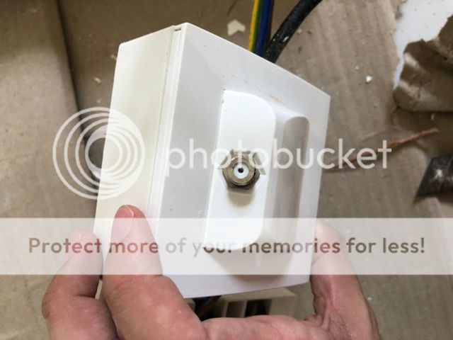

Anyone knows how to use this port?
I tired connecting this to router --> actiontech--> scv tv point --> the following picture (tv port ) ---> actiontech.
Does not work.
Does not work.
Of course this will not work lah. This connect to the roof top antenna, the old TV analog broadcast.
