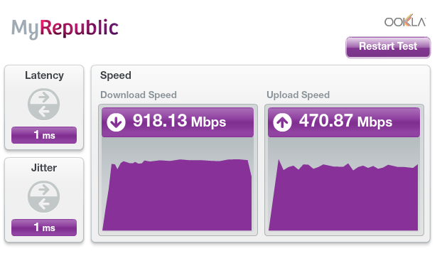

Didn't had time to go through the pages since my last post but just to make it short and sweet.
1) I can confirm that the MTU mismatch issue does exist. My sweetspot is 1472 and everything will work but otherwise the net goes all wonky.
2) AC68U does have this issue where the speed gets cut down to a max of 300mbps for no apparent reason, similar to the finding of one of the user; I found out that I cannot do any Lan Custom IP Pool Address allocation otherwise my speed keeps cutting cut randomly.
Only factory reset can fix the issue and so I have refrain from doing too much to the AC68U, however I do have Custom SSID for wireless and everything is ok so far.
Speedtest done while writing my post.
Download speed may have dropped by abit since I got it installed.
Silkworm

hanszz
Mar 26, 2012
58
I'm still getting low speed today ever since MR came to install 1gbs on 28-March.
Same disappointing results on 29-Mar and today.
Last Result:
Download Speed: 184570 kbps (23071.3 KB/sec transfer rate)
Upload Speed: 126863 kbps (15857.9 KB/sec transfer rate)
Latency: 3 ms
Jitter: 1 ms
Sunday, 6 April, 2014 10:32:47 AM
Last Result:
Download Speed: 320896 kbps (40112 KB/sec transfer rate)
Upload Speed: 129396 kbps (16174.5 KB/sec transfer rate)
Latency: 3 ms
Jitter: 1 ms
Sunday, 6 April, 2014 10:33:58 AM
Last Result:
Download Speed: 292458 kbps (36557.3 KB/sec transfer rate)
Upload Speed: 134540 kbps (16817.5 KB/sec transfer rate)
Latency: 3 ms
Jitter: 1 ms
Sunday, 6 April, 2014 10:36:13 AM
Tested using MR own speedtest server, direct connect to ONT (black alcatel-lucent), antivirus turned off.
Customer ID C1000069.

Just a few sanity checks:
1. Is your NIC gigabit compatible?
2. Is your cable at least CAT5 certified?
3. Are you running AVAST or some antivirus that scans your network traffic?
Lets see if we can narrow down the problem ...

how u get to this website?
hanszz
Mar 26, 2012
58
1. Yes, it's gigabit, connected at 1gb.
2. Tested using cat5e and cat6 cables, both gave similar results.
3. Nope, antivirus was turned off during testing
