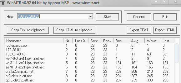

I highly doubt I will get a response but can anything be done to the ping to ESO server ?
Average 235ms and worst spike would be at 320+
1Gbps Gamer Ultra.

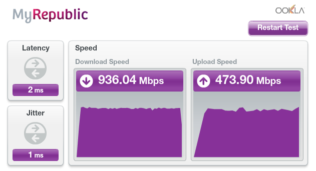

hangyong
May 9, 2002
3,838
am using voice and using the AC68U
speed was about 200+ down and 400+ up via the router, and 700+ down and 400+ up via ONT directly.
Tonight backside itchy...
restored the AC68U after re-installing merlin firmware.
surprise surprise... the speed went up to 600+ down and 400+ up via router.
I slowly configured the router and after every save, reboot, and tested with MR speed test site.
finally found that once I select the traffic monitor to "others" instead of "RAM", the speed goes down to 200+ down and 400+ up.
restored again, and immediately did speed test, 600+.
selected "others" to store the traffic data to thumb drive... speed drops to 200+
Then pulled out the N66u.
exactly the same issue...
now on AC68u again for the last hour (with the traffic monitor set to RAM)... everything is ok.
