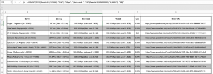

Have put together a simple shell script that just sequentially tests various servers.
Code:
#spdt.sh
#!/bin/bash
# Singtel
speedtest -s 25960
# ViewQuest SG
speedtest -s 2054
# PT FirstMedia - Singapore
speedtest -s 7556
# Comcast - Sacramento, CA
speedtest -s 9436
# Spectrum - Los Angeles, CA
speedtest -s 16974
# University of Texas, Austin - Austin, TX
speedtest -s 16089
# Optus - Melbourne, AU
speedtest -s 30932
# Misaka Network Inc - Tokyo, JP
speedtest -s 44988
# SIMPLYCONNECT - Dar es Salaam
speedtest -s 13902
# Bell Mobility - Vancouver, BC
speedtest -s 17402
# Telstra International - HK
speedtest -s 44340

ServerLatencyDownloadUploadLoss
Singtel - Singapore (id = 25960)2.23 ms (0.11 ms jitter)949.42 Mbps (data used: 954.1 MB )946.35 Mbps (data used: 1.1 GB ) 0.0%
ViewQwest - Singapore (id = 2054)2.56 ms (0.09 ms jitter)940.87 Mbps (data used: 913.9 MB ) 937.66 Mbps (data used: 1.1 GB )0.0%
PT FirstMedia - Singapore (id = 7556)1.79 ms (0.11 ms jitter)943.65 Mbps (data used: 458.8 MB )935.92 Mbps (data used: 1.2 GB )0.0%
Comcast - Sacramento, CA (id = 9436)183.62 ms (0.16 ms jitter)888.23 Mbps (data used: 1.4 GB )143.33 Mbps (data used: 196.5 MB )0.0%
Spectrum - Los Angeles, CA (id = 16974)186.75 ms (0.19 ms jitter)930.08 Mbps (data used: 1.4 GB )151.29 Mbps (data used: 262.8 MB )0.0%
University of Texas, Austin - Austin, TX (id = 16089)233.51 ms (0.13 ms jitter)184.03 Mbps (data used: 265.4 MB )28.07 Mbps (data used: 42.9 MB )0.0%
Optus - Melbourne (id = 30932)107.39 ms (0.06 ms jitter)937.89 Mbps (data used: 1.4 GB )179.91 Mbps (data used: 239.9 MB )0.0%
Misaka Network, Inc. - Tokyo (id = 44988)77.70 ms (0.16 ms jitter)650.75 Mbps (data used: 891.4 MB )235.86 Mbps (data used: 257.0 MB )0.0%
SIMPLYCONNECT - Dar es Salaam (id = 13902)479.04 ms (7.04 ms jitter)1.73 Mbps (data used: 2.8 MB )15.98 Mbps (data used: 26.9 MB )0.3%
Celcom Axiata - Kuala Lumpur (id = 4956)228.08 ms (0.17 ms jitter)656.44 Mbps (data used: 1.0 GB )119.44 Mbps (data used: 127.2 MB )0.0%
Bell Mobility - Vancouver, BC (id = 17402)259.97 ms (4.21 ms jitter)865.50 Mbps (data used: 1.2 GB )112.60 Mbps (data used: 130.9 MB )0.0%
Telstra International - Hong Kong (id = 44340)34.24 ms (0.86 ms jitter)948.45 Mbps (data used: 1.1 GB )465.70 Mbps (data used: 677.6 MB )0.0%
Just did a test run and copy/pasted the info.
Singtel - Singapore (id = 25960)2.23 ms (0.11 ms jitter)949.42 Mbps (data used: 954.1 MB )946.35 Mbps (data used: 1.1 GB )0.0%
Your results seem to be very good for SIngtel 1Gbps plan.
My results are much lower (tested using Raspberry Pi 400 runing OpenWRT 21.02.01, ignore the local upload speed because I have a SQM-QoS rule to limit to 500Mbps).
Test is not done in the optimal time though -- Singtel TV is on, family members are using Youtube and other apps.

As requested by @rubicon, Speedtest on Singtel at 10pm on a Saturday night. Network under light load - one Netflix, two surfing textual sites. Ubuntu server on a ethernet connection, direct to switch.
ServerLatencyDownloadUploadLossShare URL
Singtel - Singapore (id = 25960)1.69ms (Jitter = 0.08ms)948.3Mbps (data used: 7.2GB)945.07Mbps (data used: 9.0GB)0.00%https://www.speedtest.net/result/c/9b4333aa-d953-4084-8257-f00cde35b68d
ViewQwest - Singapore (id = 2054)6.32ms (Jitter = 1.06ms)932.04Mbps (data used: 5.3GB)933.98Mbps (data used: 8.9GB)0.00%https://www.speedtest.net/result/c/ac5ef3e3-b82a-4476-9e49-964459b0b273
PT FirstMedia - Singapore (id = 7556)1.92ms (Jitter = 0.13ms)935.85Mbps (data used: 3.9GB)935.76Mbps (data used: 9.6GB)N/Ahttps://www.speedtest.net/result/c/db281191-dda7-412e-a877-76bf00a463ad
Comcast - Sacramento, CA (id = 9436)189.49ms (Jitter = 0.16ms)842.63Mbps (data used: 10.8GB)119.97Mbps (data used: 1.7GB)0.00%https://www.speedtest.net/result/c/b23d8bb7-7f02-4485-aa4a-389dd2d3a50d
Spectrum - Los Angeles, CA (id = 16974)194.46ms (Jitter = 0.16ms)910.71Mbps (data used: 11.3GB)143.4Mbps (data used: 1.6GB)0.00%https://www.speedtest.net/result/c/94cabfba-7c60-4b0e-b606-23bcabb60ae4
University of Texas, Austin - Austin, TX (id = 16089)218.02ms (Jitter = 0.13ms)351.02Mbps (data used: 4.0GB)35.18Mbps (data used: 0.5GB)0.00%https://www.speedtest.net/result/c/ca9a1e32-1aff-4a8c-ab97-b45e4762c90e
Optus - Melbourne (id = 30932)109.36ms (Jitter = 0.14ms)946.95Mbps (data used: 12.8GB)247.05Mbps (data used: 3.5GB)0.00%https://www.speedtest.net/result/c/e3f34627-a8c7-49da-b29d-60ba15dd81d2
Misaka Network, Inc. - Tokyo (id = 44988)80.84ms (Jitter = 0.37ms)940.0Mbps (data used: 12.8GB)281.46Mbps (data used: 2.9GB)0.00%https://www.speedtest.net/result/c/91a167ce-36ac-46e2-872e-1c4f04cd1b4e
SIMPLYCONNECT - Dar es Salaam (id = 13902)451.37ms (Jitter = 3.77ms)5.09Mbps (data used: 0.1GB)8.03Mbps (data used: 0.1GB)0.00%https://www.speedtest.net/result/c/b5acd500-d4a9-42ad-94d5-54beddb3a818
Celcom Axiata - Kuala Lumpur (id = 4956)236.98ms (Jitter = 0.08ms)481.58Mbps (data used: 5.5GB)133.41Mbps (data used: 1.2GB)0.00%https://www.speedtest.net/result/c/31c9e040-f3ff-486d-9a57-5e7e4afe6336
Bell Mobility - Vancouver, BC (id = 17402)247.86ms (Jitter = 0.07ms)897.7Mbps (data used: 10.1GB)110.4Mbps (data used: 1.5GB)0.00%https://www.speedtest.net/result/c/45b6af1e-316a-4d34-ae56-89b8bc0cea98
Telstra International - Hong Kong (id = 44340)34.26ms (Jitter = 0.11ms)930.79Mbps (data used: 8.5GB)377.14Mbps (data used: 3.8GB)0.00%https://www.speedtest.net/result/c/d5d9f42f-4f49-42bd-944c-7a176291e5c1
PS: Figured out the formula is a hard 1/8 of 1,000,000. Thanks again @xiaofan. Updated the formula.
Have created an Excel sheet that automatically imports the numbers from the export csv, converts the numbers to a more human-readable format.
Update2: Created a new sheet that changes the layout of presented data to match the CLI output. Simple concatenation and text formatting formulae (See screenshot)
Link to Excel file: https://file.io/tIUbNTBew8CQ
Open it, go to Data -> Refresh. Select your exported CSV and it should automatically fill and format the data. Go to Alternate tab, copy/paste in HWZ. Done. :)

ISP: M1
Latency: 170.44 ms (0.07 ms jitter)
Download: 705.01 Mbps (data used: 866.4 MB)
Upload: 175.74 Mbps (data used: 189.1 MB)
Packet Loss: 0.0%
Speedtest by Ookla
Server: University of Texas, Austin - Austin, TX (id = 16089)
ISP: M1
Latency: 200.87 ms (0.50 ms jitter)
Download: 60.83 Mbps (data used: 92.4 MB)
Upload: 27.49 Mbps (data used: 53.4 MB)
Packet Loss: 0.0%
Result URL: https://www.speedtest.net/result/c/41dbff51-3a8a-45db-99be-4c7116d69461
Speedtest by Ookla
Server: Optus - Melbourne (id = 30932)
ISP: M1
Latency: 144.50 ms (7.42 ms jitter)
Download: 72.25 Mbps (data used: 99.3 MB)
Upload: 187.38 Mbps (data used: 322.3 MB)
Packet Loss: 0.0%
Result URL: https://www.speedtest.net/result/c/8c5b752c-cc74-46d1-b517-c62a68d0a54f
Speedtest by Ookla
Server: Misaka Network, Inc. - Tokyo (id = 44988)
ISP: M1
Latency: 112.51 ms (13.14 ms jitter)
Download: 969.63 Mbps (data used: 1.5 GB)
Upload: 139.45 Mbps (data used: 222.9 MB)
Packet Loss: 0.0%
Result URL: https://www.speedtest.net/result/c/2da683f4-8513-4350-8d59-111d59c09b34
Speedtest by Ookla
Server: SIMPLYCONNECT - Dar es Salaam (id = 13902)
ISP: M1
Latency: 266.90 ms (0.22 ms jitter)
Download: 6.59 Mbps (data used: 9.5 MB)
Upload: 25.65 Mbps (data used: 43.3 MB)
Packet Loss: 0.3%
Result URL: https://www.speedtest.net/result/c/d273df13-1598-4dd4-916f-ed0181895ed7
Speedtest by Ookla
Server: Bell Mobility - Vancouver, BC (id = 17402)
ISP: M1
Latency: 230.18 ms (0.31 ms jitter)
Download: 764.72 Mbps (data used: 1.1 GB)
Upload: 169.85 Mbps (data used: 283.6 MB)
Packet Loss: 0.0%
Result URL: https://www.speedtest.net/result/c/83bf175e-e57e-43c9-8902-8c983dd41161
Speedtest by Ookla
Server: Telstra International - Hong Kong (id = 44340)
ISP: M1
Latency: 31.91 ms (0.08 ms jitter)
Download: 915.16 Mbps (data used: 1.2 GB)
Upload: 218.35 Mbps (data used: 398.4 MB)
Packet Loss: 0.0%
Result URL: https://www.speedtest.net/result/c/5040d173-fd4f-4726-8bb8-08d29c5ac295
moral of story: m1 international upload is capped at 200mbps
note: upload does not exceed 800mbps due to bufferbloat qos on my side
