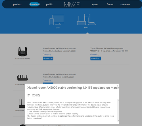

Been using the firmware for close to 3 weeks. Stable for me.
both AX9000(MESH) are CN version.
Bricked a non CN version after flashing a Docker enabled FW 6mths before but have since recovered. :o

I only found out its a non CN version after it was flashed(bricked) with 1.0.140.
After it was recovered with 1.0.155 there are no more VLAN settings.
it seems non CN versions boots up on a different partition (secure boot?)., something like a dual EFI thingy.
I do not recommend flashing CN firmware on non CN versions or vice versa.

Firmware release for CN version​
Xiaomi router AX9000 stable version log 1.0.165 (updated on July 28, 2022)​
Dear Xiaomi router AX9000 users, hello! This is an important firmware upgrade for the Xiaomi router AX9000, which not only supports new functions, but also improves the networking experience and performance, as follows:
1. Added the "Baidu Network Disk" function, open Mijia, and enter the routing application bar of Xiaomi router AX9000 to use this function. Easy click to complete remote mutual transfer of files between Baidu network disk and U disk/mobile hard disk externally connected to Xiaomi router AX9000;
2. Optimized the networking experience of Xiaomi router AX9000 and Xiaomi HomeWiFi tri-band Mesh router, and the whole network signal is stronger;
3. Improve the compatibility of Xiaomi router AX9000 and more IoT products;
4. Other known bug fixes;
