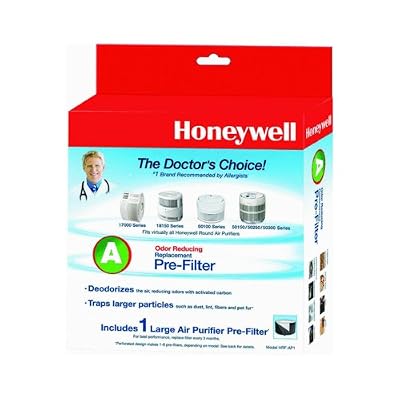

wrx bro, I need to buy replacement filters for the Honeywell 50250-S in my parents' room.
But I notice they only sell the replacement for pre-filter? Don't have any for the HEPA?
This is the pre-filter one I found:
Then the HEPA how? How to replace?

Honeywell stopped making exact replacement filters for their APs. They used to make them (model #24000 for 50250) but now they come in "modular" form where you have to stack em up to get the correct size.
The model is HRF-F1 and you'd need to stack THREE of em! Amazon does stock em (~$20 a pop) but not eligible for FSSG due to separate shipping advisory (i.e. too bulky).
Some TB sellers able to custom make circular HEPA, maybe bro WRX can help with that. The challenge would be to get a proper gasket seal on the sides.

That was actually one of the factors that drove me to trade-in my 50250 when Novita had the trade-in promotion a few months back. :s8:
Also, the downside to stacking is that you are actually trading in precious filter media area for gaskets...
