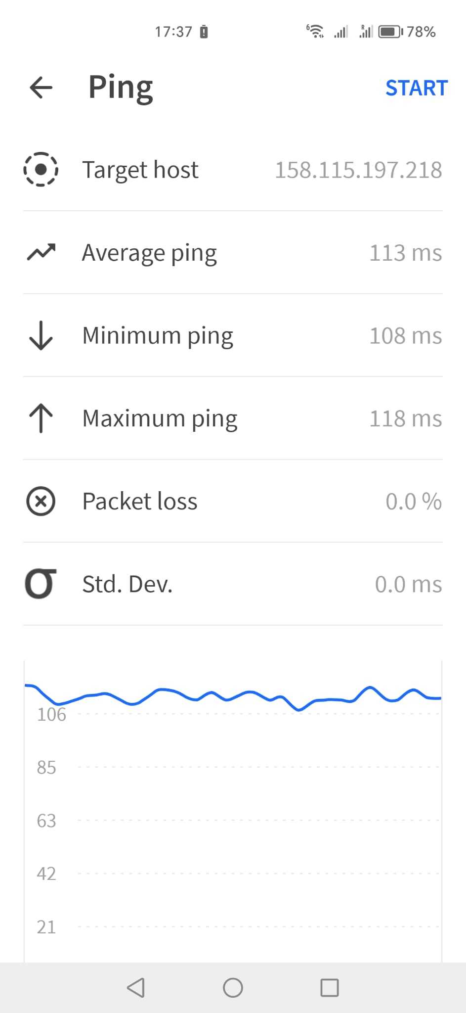

MR 10Gbps thru GT-AX6000 on PC.
Thru Android phone with "Fing".
p.s. sorry for the big file, no time to edit.
