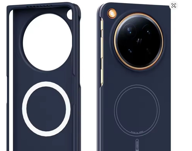

Does anyone knows where's the correct location of the MagSafe ring on the back of the N6? 2 pictures below show different locations. The top picture shows the ring is really near to the cameras. The other is far down the cameras. This is crucial for effective wireless charging. If you just want to install a ring kickstand behind then the location doesn't matter
If I take the original OPPO Find N6 case with Magsafe it shows like the below picture in the above
https://www.walmart.com/ip/Original...netic-Cover-Ultra-Slim-Back-Shell/19975670187
The oppo one which is in-between the first 2 pics is the correct placement

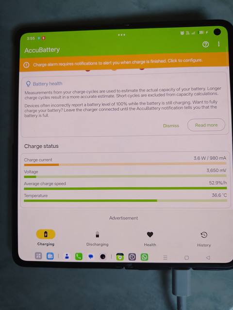

I'm not getting the 80W wired charging using the original OPPO charger and cable
Can only see the SUPERVOOC but no charge wattage like 80W
Since I cannot see th charge wattage I use the AccuBattery app to see
At 25% I see the charge wattage as 3.6W. This is for single cell measurement
After I enabled Dual cell battery mode I'm able to see 14W given the difference in the charge percentage. Basically, it's x2 in the charge wattage
So, am I having a defective charger or a fake charger? I'm going back to Singtel and ask them to demo my N6, charger and cable
there is a setting under battery for fast charge using original charger, enable that

To confirm I did another different test. I have this ANKER Power Station C300 which has 2 AC outlets. These inverter outlets has nothing to do with PD3.1 or other charging standards. They are pure sine AC outlets like the wall AC outlet
Same again. Only show SUPERVOOC with no charge wattage.
This time the ANKER Power Station registers an output wattage of 17W
It's confirming what I got earlier when tested from an AC outlet

Wu liao wu liao.......know how to test liao
All these while I totally shut down the phone and perform the charging
After I visited OPPO store I saw the guy plug in his charger with the phone on
Actually, the above test results were correct. 17W seems to be the max. Charger and cable are genuine. No such thing as 80W charging
