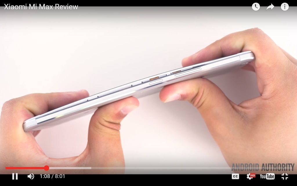

Anyone try on the mi max... the build quality is very bad sia:(
To be fair. If Mi Max were to be thicker, it'll not sell well liao. Because the feeling when using it will be bad.
So to make the experience using the phone good, it has to be thin enough, due to the screen size.
To make a thin object (with internal component) able to resist bending, it'll be a very difficult task. To make it stronger, will need to increase material used, which will compromise other aspect.
If the phone is bent and it stays bent, then jialat liao. But if it can get back to original state, personally I find ok.
Can be done.. Mine ex Sony z ultra is thinner and not so bendable
