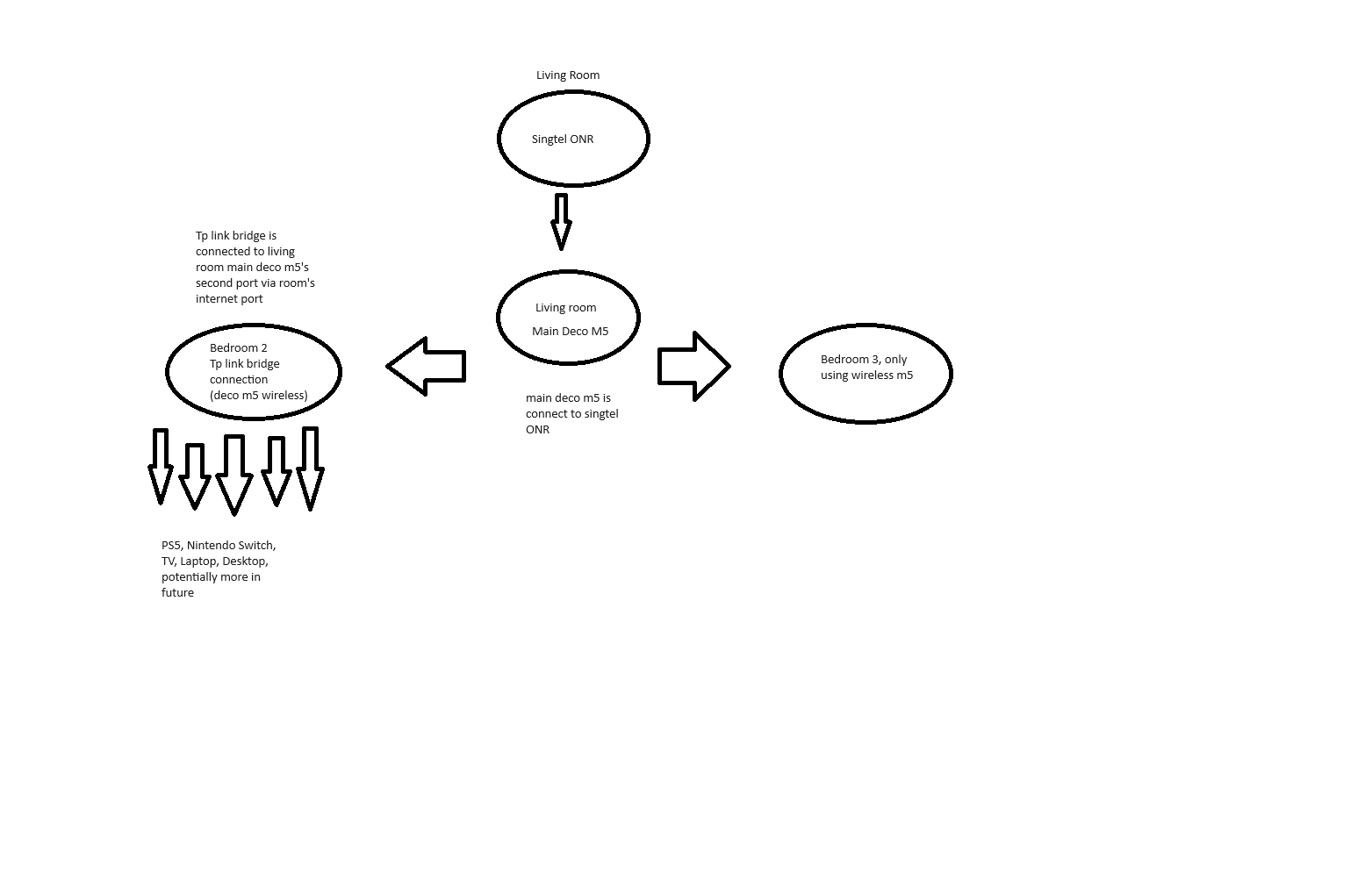

I forgot to mention in bedroom 2 , there are multiple needs for a few internet port,
What I have currently done is adding a tplink bridge in bedroom 2. The bridge connection is coming from Mesh setup, perhaps the picture will explain more. I believe my current setup is wrong and moving forward when i use m1, May I seek advise what is the proper way to include multiple internet port in both bedroom 2 and 3 if i want to?

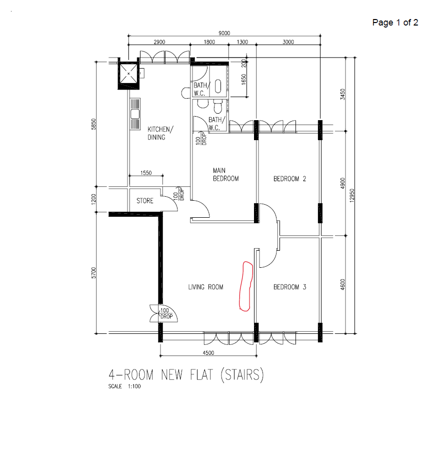

Hi, this is my floor plan and the wifi point is in red. Any good routers / mesh to recommend to reach the main bedroom (in blue)? My budget is around $600-$700. Thank you.

What do you mean by TP-Link bridge? Is it a swtch since your Deco M5 does not have enought ports?
So you have three Deco M5 units, main Deco in the living room and two more Deco mesh node in Bedroom 2 and 3, right?
Make sure you use Ethernet backhaul, which means the two Deco mesh nodes are connecting to the LAN port in the room. And make sure your main Deco is configured in AP mode. If not you are not using Ethernet backhaul proplery and are still using wireless backhaul. That may be your main problem.
So you do not have LAN ports in the rooms and you are not willing to pull cables to the rooms, right?
It is good to use triband AX mesh in this case and I think your budget should be good enough.
Asus ZenWiFi XT8 should be a good choice. Listed price is about S$699 but you may be able to find good lobangs.
