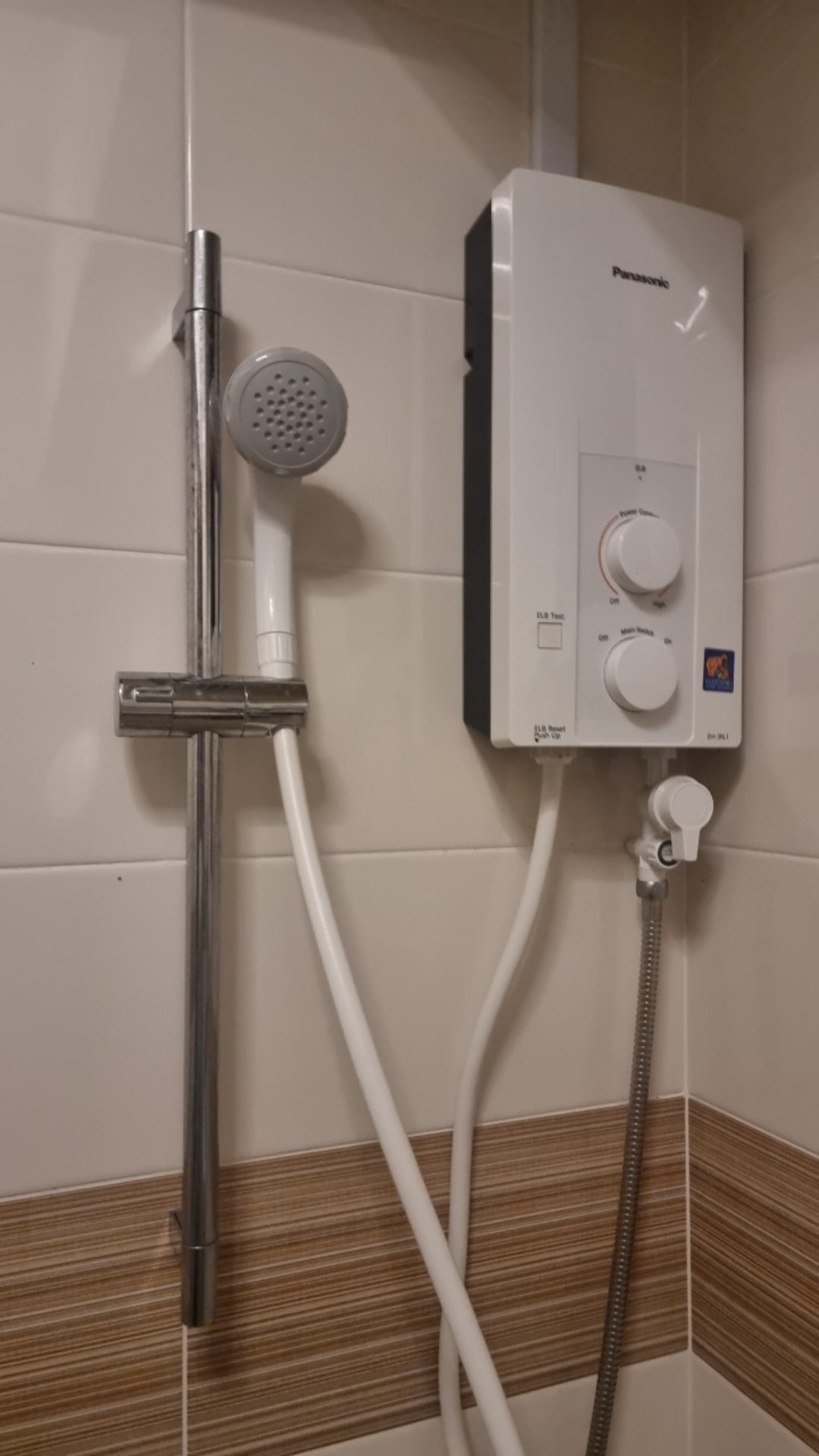

I bought the new Panasonic DH3RL1SW Water Heater to replace my old faulty heater.
I just realised the water outlet connector cannot fit in other shower head which I bought from hardware stores. Does this means I can only use shower head and hose from Panasonic only?
