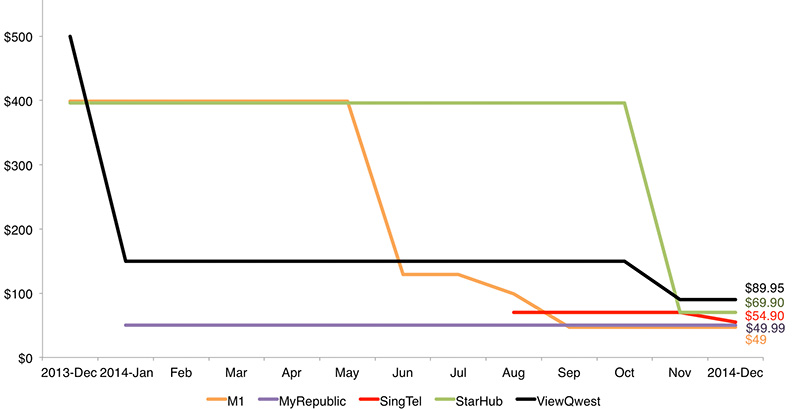

2) 2013-->2014, rapid price drop of 1Gbps services. I actually did not know that Singtel was a late comer to 1Gbps plan. MR was the disrupter then.
https://www.hardwarezone.com.sg/feature-overview-fastest-fiber-broadband-plans-singapore

4) late 2023/2024/2025 --> rapid drop of 10Gbps/6Gbps/5Gbps plan pricing.
Old info consolidated.
